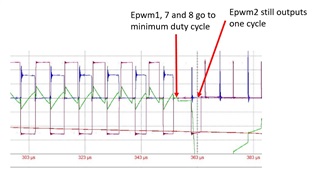

unexpected pulse at epwm2.
The configuration that we have done is:
Epwm1 is the master of epwm2, 7 and 8
All work with phase 0
Their periods are all sync with TBPRDLINK.
GLDMODE is done when the counter reaches Z(0).
All are configured in one shot mode OSHTMODE=1
We change the pwm CMPA and CMPB registers dynamically from a CLA task synchronized with the period of the pwm
we have observed that occasionally, when changing from a certain on time (something like 40% duty cycle) to a very low value (t1_cnts and t2_cnts lower than the deadtime), epwm2 takes one extra cycle to output that value, while all other modules do it immediately.

  • Hi Francois and Nada,
    Are you able to provide a scope capture of this issue while I review the file attached?
    Since TBPRD is being linked I assume the EPWM channels all have the same TBPRD? In what sequence are you writing to the compare values (CMPA, CMPB)? (ie. First updating EPWM1, then EPWM2, etc.) If you change that order do you see the extra cycle on a different output?
    I also assume that there are differences in deadtime/compare values amongst EPWM outputs (EPWM1 versus EPWM2) based on the file provided.
    For testing purposes, are you able to set the same deadtime/compare values for EPWM1/EPWM2. If so, in this case, do you still see EPWM 2 take one extra cycle?
    Marlyn
  • Hi Marilyn,
    Here the capture we obtained during testing. Notice that this extra cycle is not always present, we have seen it while performing tests at lab. We haven't tried to swap the sequence of compare registers writing but considering the fact that we are setting OSHTLD, would it affect?
  • Hi Jordi,
    Thank you for the screen capture. Which channels are shown above (ie. EPWM 2A or 2B or both?) EPWM2 looks like it misses an output and then has an output (there is no high pulse, just a low pulse).
    Also, what are your action qualifier events? In the attached file I just see the following:
    EPwm2Regs.AQCTLA.bit.CBU = PWM_CLEAR;
    EPwm2Regs.AQCTLA.bit.CAU = PWM_CLEAR;
    It might depending on when you are writing to OSHTLD and when TBCTR=zero is occurring. Would it be possible for you to toggle a GPIO when you write to OSHTLD so we can correlate when that write is happening in relation to EPWM 1 and EPWM 2?
    If possible, could you still test the following I mentioned earlier "For testing purposes, are you able to set the same deadtime/compare values for EPWM1/EPWM2. If so, in this case, do you still see EPWM 2 take one extra cycle? "
    Marlyn

    We can check with additional pin the synchronization of PWM update vs end of counter event. Unfortunately, we cannot use same deadtime/compare values for EPWM1/EPWM2.
    Jordi
  • Hi Jordi,
    Thank you, I will wait for your results.
    I also noticed that the file with the initialized code attached, only had deadband times for EPWM1 and EPWM2, are these the only two EPWM modules that have rising/falling delays?
    A few others things that could be affecting the load of EPWM 2:
    • I see you have phase shift enabled for EPWM2. In the initialization code, the phase shift is set to 0, does this change in the application? If so, this could have an effect as the TBCTR=0 event may be missed (ie. the global load condition)
    • EPWM2 has 'LOADBSYNC' and 'LOADBSYNC' defined, by default the load on a sync event is defined by 'LOADAMODE' and 'LOADBMODE' but the code is configured to only load on a sync event. You should try setting this to 1:  Shadow to Active Load of CMPA:CMPAHR occurs both according to LOADAMODE bits and when SYNC occurs (Same for B)
    Marlyn

    we have been able to reproduce the behavior by changing the code and inserting some active wait between writes to Epwm1 and Epwm2 CMPA/B registers.
    EPwm8Regs.CMPA.all = (t2_cnts+shift1);\
    EPwm8Regs.CMPB.all = (0u+shift1);\
    EPwm7Regs.CMPA.all = (t2_cnts+shift1)+(T_cnts>>1u);\
    EPwm7Regs.CMPB.all = (T_cnts>>1u)+shift1;\
    EPwm1Regs.CMPA.all = (t1_cnts+shift2+(0x20000u));\
    EPwm1Regs.CMPB.all = (0u+shift2+(0x20000u));\
    debug_wait_cnt = 0u;\
    while (debug_wait_cnt < debug_wait_period){\
    debug_wait_cnt ++;}\
    GpioDataRegs.GPADAT.bit.GPIO12 = 0u;\
    EPwm2Regs.CMPA.all = (t1_cnts+shift2)+(T_cnts>>1u);\
    EPwm2Regs.CMPB.all = (T_cnts>>1u)+shift2;\
    EPwm1Regs.TBPRD.all = T_cnts - 0x10000u;\
    EPwm1Regs.GLDCTL2.bit.OSHTLD = TRUE;\
    It seems that if Epwm2 regs are written after the PWM period event has occured, we have this behavior.
    Also OSHTLD would be written right after the period event, and if this would happen in consecutive periods we would be chaining updates on Epwm7/8/1 from cycle n, with Epwm2 updates from cycle n-1.
    Normal operation:
    Faulty operation:
    Now our question is, in case we could not guarantee that all writes happen within a single pwm period, is there a way to atomically write the values in all EpwmX so they take effect only after OSHTLD is triggered?

  • Hi Cesar,
    I don't believe we have a method to do what you are looking for. Is there a value that is the same across EPWMs then you could utilize linking (EPWMxLINK). This gives you the ability to update CMPA for example across multiple EPWM modules with a single write. This would help save some time and the risk of updating only some EPWMs and not all by the end of the EPWM period but its only helpful if the same value is needed for CMPA etc.
    It would also be enough if we could somehow know if the OSHTLD is already set but I think the bit cannot be directly read.
    The OSHTLD bit will always read back zero so there is no direct way to indicate whether the load has occurred or not.
    Do you have in mind any possible solution to this?
    Ideally, I would suggest looking at how you could prevent the CLA task from getting extended so that the timing is better aligned for your epwm updates (ie. optimize what gets done in the task). Another option would be to reduce the rate of the updates, but this isn't always ideal depending on the application.
    Marlyn
  • Hi Cesar,
    A workaround you could consider is adding a while loop in the CLA task that waits for the time base counter of EPWM2 to be 2 or 3 before you update EPWM7. Your calculations can be done, but you wouldn't write to the EPWMs until you have passed the TBCTR=ZRO condition (which would indicate a load has occurred).
    Marlyn

  • Hi Marlyn,
    We find out an optimization to apply that prevented the described event, mainly updating the adc samplig time.
    Jordi
  • Hi Jordi,
    I am glad the issue is resolved now and thank you for posting the resolution. Please don't hesitate to reach out if you come across any other concerns.
