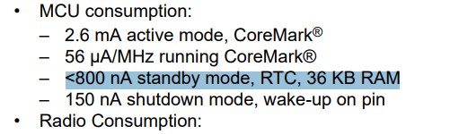

hello ,
we are facing issue in standby current of cc2340r5 , following result observed in project
1. Import Project  :  gpiostandby
                                 sleep current observed is 385 uA
2. Import Project : basic_ble
                             Sleep current observed is 483 uA
What current should be expected in new low power sdk ??
CC2340R52E0RKP device PG2.0 (Production sample)
SDK downloaded  : simplelink_lowpower_f3_sdk_7_10_00_11_eng
Thanks & Regards,
Pooja Fugare

  • Hi Pooja,
    The standby current we expect to see should be around what is mentioned in the data sheet
    Currently, what you are seeing is quite high. Are you using a custom board or a launchpad?
    Kind Regards,
    Rogelio

  • Hi Pooja,
    This will be harder to debug as it is on a custom board. I recommend firstly doublechecking that there are not external peripheral devices that could be drawing power, such as gpios, etc... If there is a way to Isolate just the CC2340R5 device for power consumption from your hardware, that would be ideal. Another option is if you have more cc2340R5 PG2.0 to solder it onto the PG1.0 Launchpad.
    Have you submitted your custom hardware for hardware review?
    Kind Regards,
