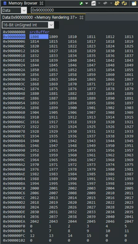

Now I can see the improper value on memory browser as following.
Of course it couldn't pass the verification stage.
I tried another case, 8000 for the value to be put to the srcBuffer.
In this case, the value I can see through Expression tab was moving in real-time as followings.
I didn't attach the screenshot for signed integer value here, but it also showed the simillar result.
I was wondering if you let me know the reason for this result.
