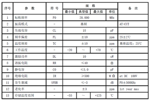

  • Hi Joseph,
    1}  I am not sure, but I know you may want us to check if any changes made to the board, I'll check with ctm
    2}  Hope you read below parameters of the crystal well, I find something not satisfying the DS, could you check?
    3) That change is from XTAL mode to single-ended input.
    Zach
  • Hio Zach,
    1) Yes, it is really helpful to know if there is a change in existing design that may affect the operation of th external crystal.
    2) As far as I can tell, the parameters for the customer's crystal choice is in line with the datasheet spec crystal spec requirements for 20MHz.
    3) Good input that clocking works with single-ended mode clock supplied to X1 pin.  At least is validates that the input clock path to the device is working.
