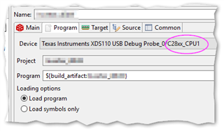

1) How to know that above imported project file shall flash the executable code in CPU1 and not in CPU2 ?

  • 1) How to know that above imported project file shall flash the executable code in CPU1 and not in CPU2 ?
    That's controlled by your debug configuration. A dual CPU project will make two build artifacts. You allocate each one to separate CPUs. This is the view for CPU1 for example.
