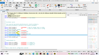

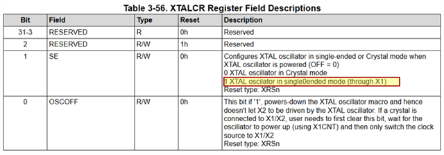

Hi Team,
The selection 11 of CLKSRCCTL1[OSCCLKSRCSEL] is 'reserved (default to INTOSC1)' according to the spruii0d_TMS320F2838x Real-Time Microcontrollers With Connectivity Manager TRM (Rev. D) P228.
But the code comment demonstrate that this selection is 'External oscillator (XTAL) in single-ended mode'.
Could you please take a look and explain of this?
