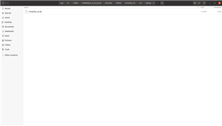

    The project explorer does contain some sort of pseudo lib file which causes a "This project contains 1 unresolved buildable linked resource(s). The project may not build as expected." warning (see bottom of attached screenshot). I guess the example expects it to be compiled already but I don't have enough familiarity with the tools and CCS to tell it to compile it from the files in the device/driverlib_cm folder, nor have I found an example project to build only the lib file

    Only a "virtual file" exists in the CCS project (see the "driverlib_cm.lib" file at the bottom of the screenshot attached to my previous mail): the file is referenced in the CCS project explorer but the file doesn't exist on the drive at the referenced path, which is probably why I get the warning and the errors at compile time. It apparently behaves like a make target because when the file is nowhere to be found, CCS tries to build from source it but does not find any way to do it and generates a "gmake" error (see log in my previous email).
    I cannot find the last folder of the path you're mentioning: in the [C2000WareInstall]/driverlib/f2838x/driverlib_cm folder, all I have are the driverlib .c and .h files (aes.c/h, cmmpu.c/h,...) and the "inc" folder. No "ccs" folder to be found. I downloaded C2000Ware from the resource explorer in CCS and I'm working on Linux. Is it possible that one of those two things made it so I don't have the whole package ?
    I finally found a solution however: Going into properties>C/C++ General>Paths and Symbols>Source Location and adding the folder containing the source files and then deleting the driverlib_cm.lib "virtual file" makes it so I can build without errors

  •  Josel,
    If you browse in the downloaded folder for C2000ware, then the driverlib_cm.lib should be located in C2000WareInstall]/driverlib/f2838x/driverlib_cm folder.
    Will check on a Linux machine and get back to you.

  • Josel,
    The driverlib_cm.lib does exist in the installed package.  Not sure why you are unable to view it.
    Can you try reinstalling the package from https://www.ti.com/tool/C2000WARE#downloads
