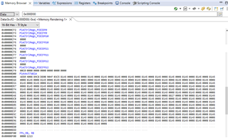

Does this vector table look correct or is it loaded with repeating gibberish? Shouldn't left hand capture be the data from table symbols shown right hand capture?

    Why does the table have seemingly incorrect data pertaining to the table being loaded is the question being asked?
    Note the reserved ISR words are showing as negative offset addresses by 6 words or so.
  • Hi Gi,
    The PIEVECTTABLE memory browser should have the updated address. Only the first few which are reserved should have the same repeating address.

    The project PIVECTTABLE has SCI ISR context functions with strut members used as Boolean flags and unions of project variables fail to assert or pass any data. Otherwise, the left hand suspect table seems to load but the data is not the same as the right hand table. Although the very same IER's are executed and nested in both projects in the exact same functions. Should not both PIE tables be exactly the same?
    There is another older post where someone had issues with end of the table being truncated due to GEL file, shows reserved words 0x0 starting at 0xd00. Hence the other question was why reserved words are seemingly shifted downward in the addresses. If they are reserved words they would seemingly be 0x0 - correct? Are you saying the reserved words start below 0xd00?

    Since it is two different projects, it will be having different PIEVECTTABLE addresses.
    But I tried from my side and was not able to get the repetition issue that you have observed.
    The reserved ISR had same address and different for others.
