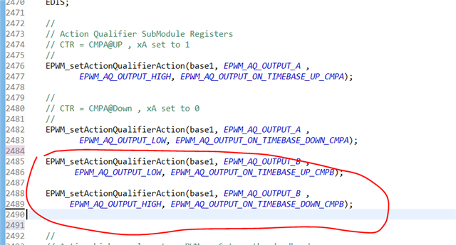

  • Hi Marlyn,
    A new information,
    I think I have found the reason why channel2 and channel 3 PWM disapper,
     when I disable DB module ,I need add AQ configuration sentence about thease two channel as below,then all pwm are normal as below:
    So it seems the DB module is the root cause of this issue?  Did my configuration have any problem about DB module in pervious code? If no problem,
    how can we use DB and don‘t cause this issue? Thanks!
