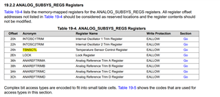

When do the debug in CCS, find that Temperature Sensor Control Register  only available by CPU1.
But is there documented that this register only available by CPU1 in Technical Reference Manual?
I want to double confirm this important infotmation.
    Thank you for the feedback.  The temperature Sensor Control register, as well as the other registers in the above table is accessible only from CPU1.  We will add a note in the TRM to specify this.  This note will be available on the next TRM version.
