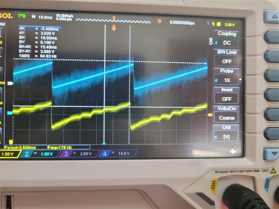

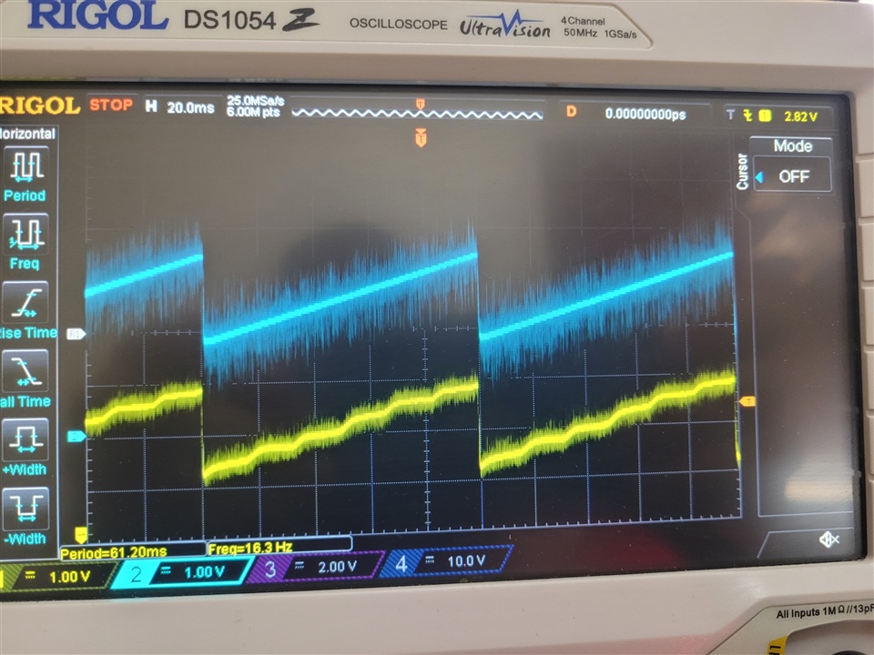

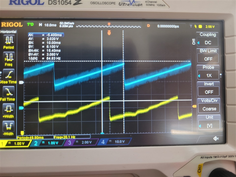

Hello TI experts,
I am going to control a PMSM motor using foc algorithm. I have designed a board which contains a f28065 microcontroller. In order to do that I started with ti application notes. Then I customised it according to my board.
I got started with HVPM_Sensorless project. I have followed the application note untill LEVEL4 successfully. Since my motor is not equipped with encoder, I move on to LEVEL 6. First, I set lsw to 0 then in watch window I change it to 1, finally when the rotor speed is close to speedRef, I set it to 2. In this process I have ran into some problems.
1- sometimes, when I set lsw to 1, motor starts vibrating and makes a lot of sounds and it doesn't rotate at all.
2- when lsw is set to 2 and rotor is rotating, if I physically stop the rotor and release it, it becomes unstable and also rotates in opposite direction.
Could you please tell me what I should do?
