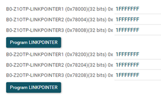

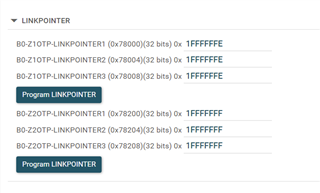

Hello, I have used dcsm function of 280025. After using the first password area to configure a password and burning the program, the program cannot start, as shown in the picture above
The program will work only if the LINKPOINTER is linked to the next security configuration area 0xFFFFFFFE,Password not written to security zone 2

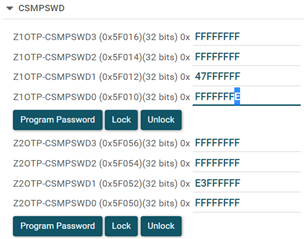

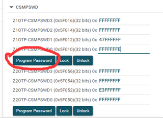

  • Hello, I have reviewed the detailed document and carried out the following operations again, but there will be an exception, as follows
    Use the first safety zone
    Set the password of the first security zone. I cannot start the program when I power on again

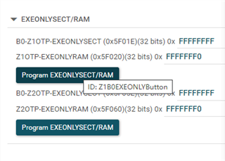

    Modify the next two registers and click the program GRABSECT1 button
    Powering back on after operation can run the program, but my XDS100V2ISO emulator can no longer connect to my hardware
    I have confirmed that the emulator connection failure is caused by my above operations,
    Do I have any other registers not set correctly
    please help me how to solve this problem, thank you
  • You have secured all the flash sectors and RAM hence you can not connect to CCS. This is ECSL feature of the device. Please refer the TRM for more detail about ECSL feature. You need to boot device in WAIT BOOT to be able to connect to CCS.
