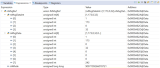

By watching the varible of the rxMsgBuf, here's what I got
The values shown in rxMsgData (unsigned char, or 0 - 255 if look as numbers) and the rxWhole (uint64_t) seems reasonable to me.
But I don't understand why the rxMsgDataInt has 4 entries which is same as the first 4 of the rxMsgData. I was expecting it interprets each 2 bytes together, and get 4 integers from the 8 bytes data, which should be different values compared to the way rxMsgData interprets. Their address in memory also make me confused since it looks like the address gap among the array members of uint16_t rxMsgDataInt[4] is the same as that of unsinged char rxMsgData[8] (increment is 1 for both cases).
Could you share you advice that what I missed? Thanks.
Wei

    Again, the uint16_t array's entries shows same value as the first 4 elements of uint8_t array. And their 'Type' both shows as 'unsigned_int'. The address of the corresponding entries of the 2 array are also the same. This leads me to the assumption / understanding:
    1. internally, the uint16_t and uint8_t are actually same type which is "unsigned int"
    2. According to your comments, since C28x is 16-bit system, so the "unsignd int" takes 16 bits, that is why when looking at the address of the entries of the uint16_t and uint8_t array, they both simply increment each by 1 i.e. 16 bits.
    Please let me know whether my assumptions or understanding are correct.
