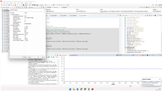

I am running DRV830x-HC-C2-KIT with INSTASPIN-FOC GUI.
I have following questions regarding the motorware_1_01_00_18 Lab solutions:\ti\motorware\motorware_1_01_00_18\docs\labs .
Lab Name: Lab1b
Following are the steps I performed:
  1. Click Tools->Graph->Dual time in CCS menu. Click the Import button and select the appropriate single or dual time file from “..\sw\solutions\instaspin_foc\src\proj_lab01b_d1&d2_1.graphProp.”
  2. Click Tools->Graph->Single time in CCS menu. Click the Import button and select the appropriate single or dual time file from “..\sw\solutions\instaspin_foc\src\proj_lab01b_d3_1.graphProp.”
Post following these steps, I could not see any waveform in the graph window.

  • Post following these steps, I could not see any waveform in the graph window.
    Run the lab to spin the motor and click the continuous refresh on the graph tool window.
