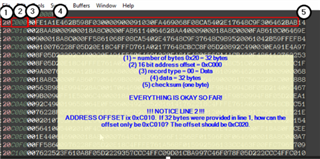

i am using flashing tool to load application hex.
Tool is not sending all data . because of address offset issue.
Address offset in hex is shift by 0x10 because i selected ROM width 16 in CCS hex utility.  hence tool is sending half data only ( 16 bytes only ).
Flashing tool require memory offset 0x20 to send all 32 bytes data. is there any option in CCS hex utility to make address offset 0x20 ?
if i keep room width blank (0)  in hex utility then hex address offset is 0x20 but this hex will not work properly with uniflash tool so it is incorrect hex.
Flashing tool company is telling their script require 0x20 address offset which is standard format of hex.
It is very high priority topic please help me to resolve this issue.
please check blow snap for more understanding.
  • I've been through this pain myself. The cause is that the minimum addressable unit (MAU) for C2000 is 16bits. In your hex file Column 2  is strictly correct because that is the correct starting address for the next 16 words (32 octets) in the record. If you change the "offset" in column 2 that would be the wrong address for the device.
    The flashing tool however (I presume) does not know that the MAU is 16 bits so creates the serial byte stream incorrectly.
    As an interim containment measure, can flashing tool use .bin files?
    You could try playing around with romwidth and memwidth settings but this often produces more than one hex file spanning the same address space. I never found a solution that would produce a single hex file.

  • Hi All,
    the tool vendor informed me that their tool supports standard intel hex file (data length 0x20 with memory offset 0x20.)
    CCS hex utility generated hex with data length 0x20 with memory offset 0x10 ( becuase of romwidth  16) hence vendor tool does not support to such kind of format.
    vendor tool script check memory offset and length in transfer service of UDS.

  • Hi ,
    Tool vendor inform me ECU Flasher in tool is generic and it's not any controller specific then what is the issue with  TI intel hex file format.
    Rahul Jathar
  • what is the issue with  TI intel hex file format
    The reply by Kier explains the issue.  I'll say the same thing a different way.
    The smallest unit of memory the C28x CPU can address is not an 8-bit byte, but a 16-bit word.  That is, each address corresponds not to an 8-bit byte, but a 16-bit word.  One place this shows up is in the output of the hex utility.  One line of output typically contains 256 bits of code or data.  Presume the next line is contiguous in memory.  It is natural to expect it to increment the address by 256/8 = 32 (0x20).  That is not what happens.  Because each C28x CPU address corresponds to a 16-bit word, the address increments by 256/16 = 16 (0x10).
