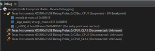

I am trying to run a simple addition program in the C2000 launchxl TMS320F28379D module.
I can build the program but cannot debug it. I am facing these issues. Please look at it and give me the fix.

Hello Mohammed,
It looks like the Debug window shows you're connected (C28xx_CPU1 is the primary CPU, which is likely where you're running the program), is there some error that shows up in the console? If so, have you tried running Test Connection in the second image you posted?

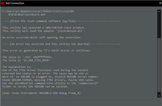

this is the message popped in the console.
I just performed the test condition, there are some errors thrown here
What am I doing wrong and how to fix it
Hi Mohammed,
Are you able to see the XDS100 for your launchpad in the windows device manager?
Could you take a look at the troubleshooting steps on this page? https://software-dl.ti.com/ccs/esd/documents/ccs_debugging_jtag_connectivity_issues.html
