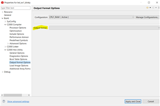

I use EVM to do SCI firmware updates. The kernel and application code are below.
■ kernel: flash_kernel_ex3_sci_flash_kernel
■ Application code: led_ex1_blinky

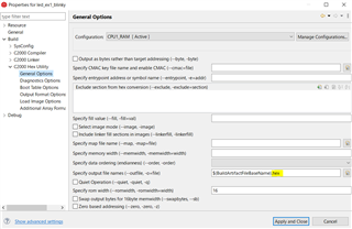

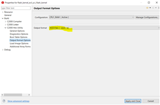

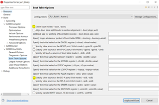

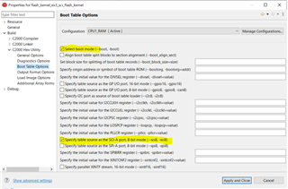

On CCS, from "flash_kernel_ex3_sci_flash_kernel", I took the following steps to output a TXT file.
1. Enable C2000 Hex Utility
2. Select boot mode, select SCI-A
3. Select ASCII hex in output format
4. Copy the text file generated by building
Send the following command
・serial_flash_programmer.exe -d f28003x -k flash_kernel_ex3_sci_flash_kernel.txt -aled_ex1_blinky.txt -b 19200 -p COM12
After performing the above steps and executing the Flash kernel, the following screen is displayed.
As far as Figure 6-1 in the document below is concerned, after the kernel has been downloaded, "Kernel loaded!" should be displayed.
https://www.ti.com/lit/an/sprabv4e/sprabv4e.pdf
On my screen it seems that "kernel loaded" is not being transferred successfully as it is not shown. Could you please check if there are any problems with the txt output method and the transfer procedure?
Also, is there no problem with the application code in the same procedure?

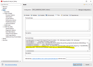

  • Hi Conor,
    Can you please check if post build steps are correct as per shared image?
    Also in your shared command space is missing between "-aled_ex1_blinky.txt" . Check by giving space as below.
    serial_flash_programmer.exe -d f28003x -k flash_kernel_ex3_sci_flash_kernel.txt -a led_ex1_blinky.txt -b 19200 -p COM12
    Hope this shall resolve your problem.
    Rajeshwary

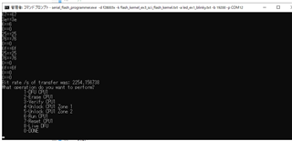

  • Hi, Rajeshwary
    The "build step" was the same description as yours. I ran the command you mentioned, but the same thing happened.
    By appending -v to the command, verbose content was displayed in the command prompt. As far as I can see from this display, the kernel seems to be sent normally, but it stops at the screen waiting for the application code to finish downloading.
    Do you know what the cause is?
    Conor
  • Hi Conor,
    Its seems its getting stuck in getPacket() after loading.
    Can you please check by putting breakpoint and debugging if you have visual studio?
    You can find code at C2000Ware_X_XX_XX_XX\utilities\flash_programmers\serial_flash_programmer.
    Rajeshwary

    q
    Also, the EVM's onboard boot switch (S3) is set to Wait mode. I don't need to change anything else from the defaults, right?
    Conor
  • Hi Conor,
    I will check and get back to you with my findings.
    Rajeshwary
  • Hi Conor,
    I tried  with your shared Flash kernel and led_blink.txt file on my environment.
    I am also observing the same behavior as yours.
    Next I tried by generating Flash flash_kernel_ex3_sci_flash_kernel.txt and led_ex1_blinky.txt  from C2000Ware_4_03_00_00 and it ran successfully. Attaching both the txt files, you can cross check.

    There has been progress. It was an error that occurred because the following was not changed from hex to txt in the application code settings. Application code is now loaded by changing to txt as shown in step 4 below. I am using a txt file with the following changes by importing the sample project.
    ①Enable Hex Utility
    ②Enable select boot mode, specify table source as the SCI-A from Boot table option
    ③Enable ASCII hex in Output format
    ④Change ${BuildArtifactFileBaseName}.hex to .txt in General Options
    But a new problem has arisen. The code I run with these gives the following error: I'm not sure why this error occurs, so please let me know.
    No changes have been made except for ① to ④.
    I would like to understand why this error occurs, as we will test the application code that we have made in the future. For reference, I have also attached the project where I made the settings and the error occurred.

  • Hi Rajeshwary
    As far as I can see in the settings of the project you sent me, it seems that the settings in the yellow line have not been done.
    Don't you need the yellow line setup I'm doing?
    I have a feeling that this setting will output a HEX file instead of a TXT file.
    Conor
  • Hi Conor,
    Yes setting are required. I have added it in other way as a post-build steps
    Rajeshwary
  • Hi Rajeshwary,
    I was able to resolve this issue by changing CPU_RAM to CPU_Flash and generating a txt file!
    Can you tell me why I should change from CPU_RAM to CPU_Flash?
    Conor
  • Hi Conor,
    A flash kernel is loaded to RAM using a ROM loader - it is then executed and used to program the target device's on-chip Flash memory with the end application.
    CPU_FLASH configuration will ensure that the CPU will have access to the FLASH for loading a program. This settings are done in linker cmd file.
    Rajeshwary
