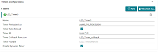

i use sysconfig example for 2838x Project (freertos_ex2_c28x_led_blinky_syscfg)
i set the softtimer, and compile
compile Error below
<Linking>
error #10056: symbol "LED_Timer0Handle" redefined: first defined in "./freertos_ex2_c28x_led_blinky_syscfg.obj"; redefined in "./syscfg/c2000_freertos.obj"
error #10010: errors encountered during linking; "freertos_ex2_c28x_led_blinky_syscfg.out" not built
Question 1: LED_Timer0Handle is not declared redundantly in freertos_ex2_c28x_led_blinky_syscfg.c file. But I am getting duplicate declaration error.
It doesn't come up in file search either.
c2000_freertos.c file in
// Declare a variable to hold the handle of the created timer.
TimerHandle_t LED_Timer0Handle;
c2000_freertos.h file in
extern TimerHandle_t LED_Timer0Handle = NULL;
Is it a redundant declaration problem by declaring extern in h after declaring in c file?
If you recompile after deleting the extern part, an error occurs because it is newly created.
What problems could there be?
    As a workaround, please update the file <C2000ware>\kernel\.meta\freertos_tool\templates line number 167:
    extern TimerHandle_t `timerInstance.timerHandle` = NULL;
    to
    extern TimerHandle_t `timerInstance.timerHandle`;
    This fix will be rolled out into the next C200ware release
    Veena
