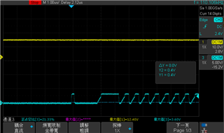

Hello, I am testing the BuckBoost routine. I use the 0039C development board to burn and then jump to the main circuit. There is no problem with the connection of CCS, but I use the XDS110 jumper to connect to the control board I designed. After the main circuit, I found that when I adjust the duty to be greater than 0.4, that is, the control board will be disconnected from the CCS when operating in equal voltage and Boost mode. I measured that the 3.3V of the control board is very stable. I would like to ask what is the problem. The picture below is the output voltage (yellow) and 3.3V (purple) on the control board when my duty is adjusted from 0.4 to 0.5

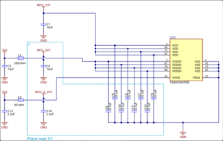

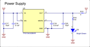

  • here is the circuit  use for control board
    Among them, I did not use the MCU 1.2V, the oscillator is the internal oscillator of the MCU

    Are you able to monitor your JTAG signals (TMS, TCK, and TDI, TDO if you're using 4-pin JTAG) with an oscilloscope? It might be possible that noise from the buck boost module is causing connection problems.
    Ben Collier
  • Hi Benjamin,

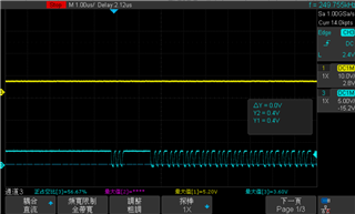

    I use the 2-pin JTAG of TMS and TCK. I measured the TMS signal and found that it is an unstable signal.

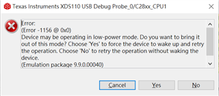

    Later the following warning will be displayed
    Ben
  • Hi Ben,
    You will likely have to reroute the JTAG signals so that they are not near anything that might be switching for your buck boost.

    Like do you see these spikes only when your duty is above a certain level? Do the spikes get larger as duty increases? Can you run your device in standalone mode and see if there are still voltage spikes on the TMS and TCK pins at certain dutys? Also, why are there only spikes on TMS and not TCK?
    Ben Collier
  • these spikes only when your duty is above a certain level? Do the spikes get larger as duty increases?
    I had a spike when I didn't give Duty after burning, and the spike didn't get bigger when I increased the Duty
    I only burn into the control board. If I don’t connect the main board, there will be spikes, but it will not be disconnected from the CCS. When I only burn into the 0039C development board, there will be spikes.
    The picture below is the signal of TCK

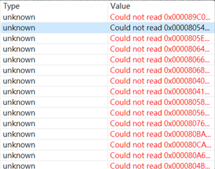

    When I measure the TMS signal, it is easy to make the following mistakes. This error does not exist when I do not measure. At this time, the TMS waveform is shown on the right.
    Ben

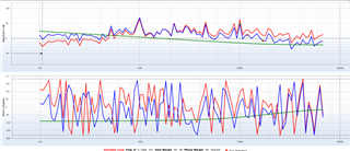

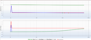

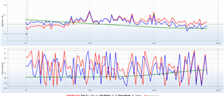

    Regarding the problem of SFRA scanning, I am now connecting and burning the TMS and TCK on the control board through the XDS110 of the development board. I tried to use SFRA to scan and found that the wave line obtained is not correct. The left picture is no load, and the right picture is In the case of loading, can I use SFRA to scan if I only use the TMS and TCK pin connections?

    I am not sure that I understand your question about using SFRA only when using TMS and TCK, could you please clarify?
    At present, after I connect the USB cable to the development board, I only have to jumper the TMS and TCK two PINs on the development board to my control board, but the waveforms scanned by SFRA are severely jittered as shown in the figure below, and there is no way to use CompDesigner. For compensation, do I need to connect other PINs to use SFRA? Or is there another way to calculate the compensation parameter value?
    Ben
  • Ben,
    Are you also connecting the ground signals? I think that would be important.
    Ben Collier
  • Hi Benjamin,
    Yes, and for more stable connect few more ground wires.
    Ben
