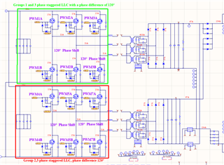

TMS320F280039C: Two groups of 3-phase interleaved LLC parallel frequency modulation current balancing function are incorrectly configured
Part Number: TMS320F280039C
Hi Team,
This question comes from the customer:
The staggered configuration function of group 1 and group 2 and 3 has been realized, but the problem is that the frequencies of group 1 and group 2 cannot be adjusted separately. The main purpose is to make group 1 and group 2 work at different frequencies and adjust the output gain of single group LLC, so as to realize parallel current sharing.
