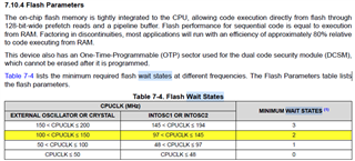

The software runs in flash from the CM of the TMS320F28388D ( FRDCNTL.RWAIT=2, CPUCLK = 120MHz).

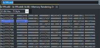

The registers then always show the following picture:
So the cause of the interrupt is an uncorrectable error at address 0x1FFFCEB8. This is always the same address. But this address points to the C1 RAM, which has no ECC. It points to the local variable "i" in the stack. This value is not the same for every attempt.
When jumping back into the code after the interrupt routine, it is always at the same place:

According to the specification FRDCNTL.RWAIT=2 should be sufficient for a CPUCLK of 120 MHz.
The solution with the NOP is more efficient than setting RWAIT=4, since two additional CLK cycles are not waited for each flash access.
