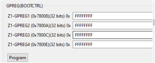

Write 0x5AFF1820 to Bootconfig (0xD00) and write 0xFFFF41FF to DefWordLow (0xD04) for emulation boot.
0x5AFF1820・・・- Lower 4 digits: GPIO24=0x18, GPIO32=0x20
0xFFFF41FF・・・ Since the SCI boot pins have been changed to GPIO8 and GPIO9, they are replaced with 0x41.
These values were written to RAM via CCS, and the SCI Flashkernel was successfully downloaded.
I plan to write to the OTP for standalone boot in the future, can you tell me what values I should write to addresses 0x00078008 (Z1 BOOTPIN Config) and 0x0007800C (Z1-GPREG3 BOOTDEF LOW0)?
Also, please tell me the procedure to write to OTP with UniFlash or CCS.

    You can re-use the same values you loaded in the EMU-xxx locations, just moving them to Z1-xxxx.
    In your .cmd file; you need to define the locations that correspond the the above BOOTPIN-CONFIG as well as BOOTDEF-LOW.  Under the "Page 1" area you will add
    Z1_OTP_BOOT_CONFIG : origin = 0x078008, length = 0x000002
    Z1_OTP_DEF_WORD_LOW : origin = 0x07800C, length = 0x000002
    In the main.c(or any .c in your project) file you now need to tell the compiler/linker what to place there(the same values that you wrote to EMU locations in RAM earlier), this will in the declaration section at the top of the file.
    #pragma DATA_SECTION(Z1_OTP_BOOT_CONFIG,"Z1_OTP_BOOT_CONFIG");
    #pragma DATA_SECTION(Z1_OTP_DEF_WORD_LOW,"Z1_OTP_DEF_WORD_LOW");
    const uint32 Z1_OTP_BOOT_CONFIG = 0x5AFF1820;
    const uint32 Z1_OTP_DEF_WORD_LOW = 0xFFFF41FF;

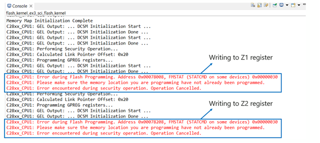

    I also checked with UniFlash, but the following error occurred and I could not write.
    My purpose is to write values to Z1_OTP_BOOT_CONFIG and Z1_OTP_DEF_WORD_LOW, so it doesn't matter which tool you use, such as CCS or Uniflash.

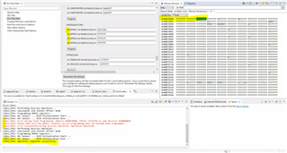

  • Conor,
    I'm not exactly sure why CCS is not programming the OTP, but there is another option to load these locations in the flash tool (in CCS) itself.
    In CCS if you select tools->On-Chip Flash it will open the flash tools window, if you scroll down there is a place to manually enter the 32-bit values we mentioned above.
    I don't see anything explicit in this tool that says "don't program OTP" when a .out is loaded, but the presence of the above option makes me curious if that is what is going on.
    I know the underlying flash API that is used allows OTP programmation.
    Matthew
  • Hi Matthew,
    I tried to write with the CCS you described, but I couldn't write with the following error. It seems that the OTP is locked.
    A similar phenomenon occurred with Uniflash.
    I don't mind using the API, so please guide me.
    Conor

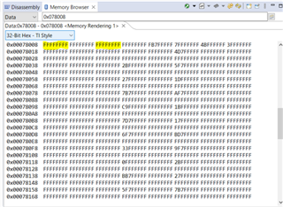

  • Conor,

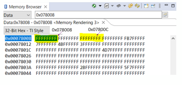

    Can you open a memory window to those locations in OTP and copy the values/screenshot here?  0x78008-0x7800F
    Matthew
  • Hi Matthew,
    Below is the memory map. What I want to know is how to write to OTP.
    Conot
  • Conor,
    The memory map is showing both of the locations of interest as 0xFFFF or erased.  CCS should be able to program these to your values.
    Let me loop in some others for comment.
    Matthew

  • Conor,

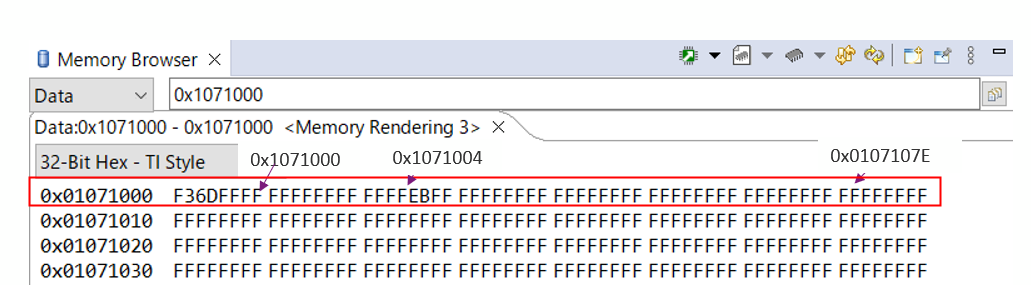

    On the device in question, can you open another memory window to address 0x1071000 - 0x0107107F.  This contains the ECC syndromes for the DCSM OTP at addresses 0x78000-0x783FF, which we are trying to program.
    It is possible, that if the OTP was attempted to be written to 0xFFFF(even though that is erased) that the associated ECC syndrome was programmed and is not 0xFFFF.  If we see contents in the associated memory range then that would be why CCS is not allowing us to program, since the ECC is OTP as well.
    The serial loader maybe having the same issue with the EVM, so will wait for your reply on the above.
    In terms of emulation boot, I believe that the boot ROM is interrogating a register called "TAP_STATUS" that will indicate if the emulation logic is active or not.  This is more than JTAG being plugged in, but that the scan sequence to connect to the device is active/complete.
    Matthew
  • Hi Matthew,
    The memory area of the custom board was the same.
    Referencing the area 0x1071000 - 0x0107107F, the following was found: 0x1071000 and 0x1071004 were values other than 0xFFFFFFFFFF.
    The DCSM OTP is most likely the problem. Can you give me some advice?
    Conor

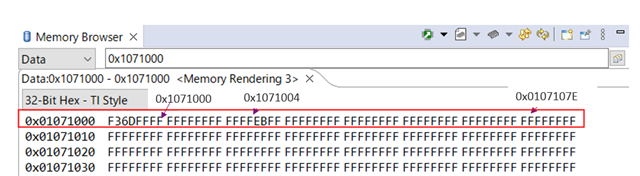

  • Hi Matthew,
    On the EVM side, memory address: 0x1071000 was 0xEBAAFFFFFF and other addresses were 0xFFFFFFFFFF.
    EVM was able to write to OTP successfully.

  • Hi Matt,
    The following is the register before writing to the Z2 register.
    Afterwards, writing was performed to Z2 register, but the same error occurred as when writing to Z1 register.
    As we have not written to the OTP of the Z2 register in the past, we believe that there is a reason other than the OTP already being written to, why we cannot write to it.

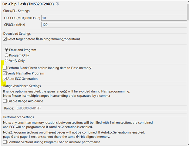

    As we have sent you before, there is a high possibility that there are other causes, as several similar errors have occurred in E2E.
    Also, we are sorry to say that we are currently unable to replace the chip in the custom board with a new chip.
    Q1. Are there any settings that need to be made when using the CCS Onchip-Flash tool? For example, the yellow checkboxes below.
    Q2. Is it possible for me to try to write to the OTP using methods other than Uniflash and CCS's Onchip-Flash tool? For example, using the Flash API sample code. I would also like to know the procedure for doing so.
    Conor
  • Conor,
    I believe you mentioned this before, but you can program the main flash array without issue on your custom PCB, correct?
    This should eliminate any kind of board level issue, that would indicate the device voltage/clock isn't proper when we are trying to program the flash.  I just want to make sure we don't need to look at the schematic for something that is causing this.
    If you can program the main array successfully there shouldn't be any reason the OTP should be giving us issues.
    I don't believe the API programming is going to give any better results than the CCS tool at this point, we need to figure out why this issue is happening.

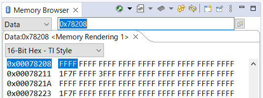

    I'm going back a few messages when I had you look at the ECC memory that corresponds to the DCSM OTP.  For every 8 16-bit words(128 bits) of OTP there is a 16-bit ECC syndrome.
    Looking back at this picture, we see that 0x1071001(or the upper 16-bits of the 32-bit word at 0x1071000) has a non 0xFFFF value.  This indicates that at some point there was a call to the flash API to "program" all 0xFFFF to address 0x70008, and the ECC got written.
    If we extrapolate this to the Z2 GPREG1 OTP address 0x70208, then you can look at address 0x107141 to make sure it is 0xFFFF.  On both your devices you should see this as non-0xFFFF; on your first device this is what was keeping us from programming it, on your new device it will be non 0xFFFF intentionally as you have programmed the Z2 GPREG1 with the tool.
    When you get a fresh device, you can verify that the Z1 or Z2 programming should be successful by looking at 0x1071001 and/or 0x107141 and verifying they are 0xFFFF(in addition to the main addresses of 0x70008 and 0x70208).
    Matthew
  • Hi Matthew,
    We first verified this with Board A. We could not access 0x107141.
    Is there a mistake in the description of 0x1071041? If so, the following was the case.
    Verification of Boards B and C will be carried out in the future. If what you are saying is correct, then 0xFFFF has been written to the Z1/Z2 GPREG1 OTP by calling the Flash API. However we are puzzled as we do not recall writing it intentionally. So we need to investigate which procedure was at fault. Is it possible for the user to write unintentionally, e.g. during debugging?
    Conor
  • Conor,
    Apologies for the typo on the 2nd ECC address.  You are correct with your 2nd window address.
    I think it would be unlikely that your code would accidentally write to this region, since it is address wise located prior to the main array.  There is a button at the end of each Security Section in the CCS flash plug in that says "Program all Z1", but this shouldn't have happened by accident.
    All that to say, I can't think of a reason this could happen unintentionally, which doesn't help explain the situation you have.  Once you get some new devices, go ahead and check those ECC regions before first program(even just for the main array), and let me know if there is anything that is not fully erased.
    Matthew
