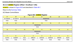

Part Number: TMS320F28386D
I2CMCS register all bits are read type.
Why write 0x03 to the I2CMCS register can initiate a transfer?

I will check to confirm this with another expert, but I believe writing to these registers is not an illegal operation, it just is used to prompt the transfer to start while not actually changing the bits. Again, I will confirm this with another expert just to make sure.
Omer Amir
Hi ,
There is a typo error , it should have been "I2CMCS_WRITE" register instead of "I2CMCS" register for the 0x3 write statement.
