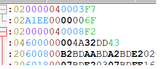

TMS320F28388D: there have data for RAM from hex file
Part Number: TMS320F28388D
Hi Expert,
My customer are using F28388D, there have data for the RAM address 0x0003A1EE when generate hex file,
FLASH12 : origin = 0x0BC000, length = 0x002000 /* on-chip Flash */
FLASH13 : origin = 0x0BE000, length = 0x001FF0 /* on-chip Flash */
// FLASH13_RSVD : origin = 0x0BFFF0, length = 0x000010 /* Reserve and do not use for code as per the errata advisory "Memory: Prefetching Beyond Valid Memory" */
CPU1TOCPU2RAM : origin = 0x03A000, length = 0x000800
CPU2TOCPU1RAM : origin = 0x03B000, length = 0x000800
anything wrong here?

  • Hello Strong,
    Can you please answer my second question? I'm not familiar enough with the format of the hex file to be able to tell if something's wrong or if there's just a question. Can you give me some context as to what the user is asking?
    Omer Amir
  • Omer,
    as customer feedback, hex file should not contain data from RAM address, but hex file that he provide contain data from RAM address which is 0x0003A1EE.
    could you check if anything wrong for C20000 compiler?
  • Omer,
    from the cmd file, 0x0003A1EE belong to CPU1TOCPU2RAM, which should not be showed in the hex file.
  • The linker map file shows this ...
    .TI.bound:DriverPowerType
    *          0    0003a1ee    00000001
                      0003a1ee    00000001     CLA09_CLAVar.obj (.TI.bound:DriverPowerType)
    .TI.bound:MotA_PwmPeriod
    *          0    0003a1ef    00000001     UNINITIALIZED
                      0003a1ef    00000001     CLA09_CLAVar.obj (.TI.bound:MotA_PwmPeriod)
    Each group of lines describes one output section.  Both of these output sections are 1 word long.  The first one corresponds to the problem address 0x0003a1ee.  Notice how the word UNINITALIZED is missing.  Compare that to the second output section.  This means the output section .TI.bound:DriverPowerType is initialized.  That's why the hex utility has output for this address.
    I don't know why this section is initialized.  But I can see it comes from the object file CLA09_CLAVar.obj.  So, for the source file CLA09_CLAVar.cla, please follow the directions in the article How to Submit a Compiler Test Case.
    Thanks and regards,
    -George
  • George,
    Thanks for your support. Customer use the below code that cause this issue.
    #pragma RETAIN( DriverPowerType )
    uint16_t DriverPowerType = 0;
    #pragma LOCATION(DriverPowerType, 0x03A1EE)
    if they change to below code, that UNINITALIZED the variable DriverPowerType, then everything is ok
    uint16_t DriverPowerType;
    actually, this address below to CPU1TOCPU2RAM, which can not be written by CPU2, and customer's hex is generated by CPU2 project,
    this may cause the issue.
  • Hello Strong,
    I'm not sure why this would cause an issue, this message RAM intentionally restricts access so CPU2 can only read or perform debug writes. Are you saying that because the CPU2 cannot write to the CPU1TOCPU2RAM, that the memory location should not be showing up in the hex file? Or is it because the RAM is shared between the CPUs?
    Omer Amir
