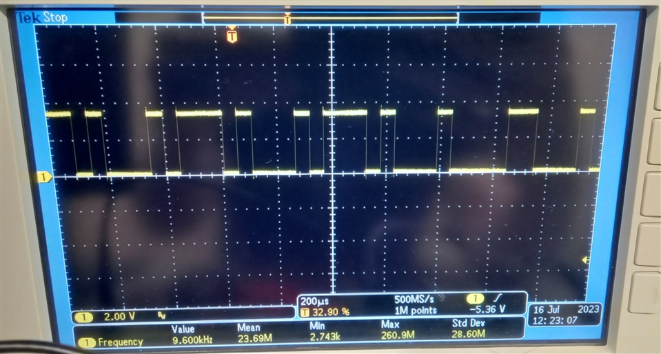

I am trying to send and receive data via SCI with TMS320F28379D controlCard Rev1.3. My goal is to read the data from the RS422.
I'm running sci_ex2_loopback_interrupts.c from C2000Ware. When loopback function is active, it goes into RX interrupt, when I examine the TX pin with an oscilloscope, I get a good signal, there is no problem here.
In the code, when I turn off the enableLoopback function and connect the TX pin (GPIO29) directly to the RX pin (GPIO29), it does not enter the RX interrupt. When I examine the registers, I see that the SCIFFFE register is 1. Isn't the RX supposed to go into the interrupt with this cable connection?
When I examine the point where I connect the two pins with an oscilloscope, I see that the voltage that should normally be 3.3V is 1.5V with an offset of about 1.8V. Where does the 3.3V voltage get this offset from? Is it because the signal amplitude is 1.5V I can't enter the RX cutout?
When I measure the RX pin at idle I see a constant 3.3V voltage.
In addition, using the same code and the code change I mentioned (only turning off the enableLoopback function), when I bring the isolated rs422 output to 3.3V with the ADM2682E and connect it to the RX pin, I see the same voltage offset signal. However, when I do not connect the RX pin of the ADM2682E to the mcu, I can read the 3.3V voltage level and the rs422 signal correctly with the oscilloscope. I tried with 2 different TMS320F28379D controlCard Rev1.3, both have the same situation.
In the sample code for everything I described above; I activate the #define _LAUNCHXL_F28379D macro and just turn the loopback function on and off, no other changes.
While the RX TX pins of the mcu are connected to each other or the signal output of the ADM2682E is connected to the RX pin. In both cases when i inspect the RX pin there is offset.
When the output pin of ADM2682E is idle.

    I connect the Rx and Tx pins with jumpers. I connect an oscilloscope to the point where the pins meet. I turn off the loopBack function in the sci_ex2_loopback_interrupts.c file in C2000Ware. I add the #define _LAUNCHXL_F28379D macro to the beginning of the code. I click the debug button in CCS and run the code. After running it, I see a communication signal with 1.8V offset and 1.5V amplitude at the junction of Tx and Rx pins on the oscilloscope screen.

    I just put a jumper between pins 76 and 78 and take measurements from this point with an oscilloscope. It is now interrupting with its own rx tx pins. But when I use ADM2682E externally, it does not interrupt. Both ADM2682E and controlCard's rx and tx pins can produce 3.3V when idle. But when I connect the Rx tx pins together or connect the corresponding pin of the ADM2682E to the rx pin of the board, the offset voltage appears. I tried with 2 different controlCards, same result. The photo shows the jumper connection type. The oscilloscope image shows the voltage of this jumper connection. The oscilloscope settings are correct.

    I also tested changing SW1 and SW2 and loading the program into flash. On my end, both SW1 and SW2 need to be in the upward position for the code to work, otherwise scoping the RX/TX connection results in an idle 1.9 V signal.
  • Perhaps the issue results from the actual jumper you are using. I am connecting two separate jumpers from RX and TX to a breadboard in the same row, and then connecting an oscilloscope to the breadboard.
  • I tried this way too, but the problem was not solved.
  • When I tried it with GPIO 64 GPIO 65 pins with rx and tx support, the problem disappeared. I still don't know why the offset is caused, but for now I will solve the problem like this. thanks.
