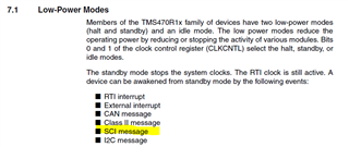

1. Set SM470 to enter standby mode and wake up through RTI interrupt. Where does the program start running after waking up? It stands to reason that the standby mode is powered off, is it equivalent to a reset?
2. It is currently detected that after exiting the low-power mode, the program can only run in the RTI interrupt, and does not restart from main(). What needs to be done in the RTI interrupt to make the program run again?
3. According to the manual, the standby mode can be woken up by SCI information, how to wake it up? Is it an SCI interrupt or does it wake up as soon as the receive buffer receives data?
    I think after wakeup, it is supposed to restart from the instruction that entered standby mode.  A wake up should not cause a reset to the device. If you look at the below LPM description, OSC, ACLK and RTICLK are still oscillator. The RTI module is still running.
    If you already confirm that after a wake up, the processor is executing an RTI interrupt then I believe the wake up is working. Once you exit the interrupt ISR, it should resume normal operation, right? Of course, you need to clear any interrupt flag before exiting ISR.
    According to the TMS470 System module user's guide, SCI can be used to wake up the clock. I think how it works is that an high to low on RX pin will cause an wake event to the clock controller to wake up all the clocks.
