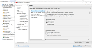

Actually I have one code found from : C:\ti\c2000\C2000Ware_4_02_00_00\driverlib\f2837xd\examples\cpu1\led, where he has used ERTM after EINT ( global interrupt ), so basically, using the above example , like I have implemented same which considers:
1. uart peripheral rx interrupt initialization
2. internal flash api for program and erase single word
3. timer interrupt
So Initially in main() function before starting while(1) we just initialize all peripherals, clocks, interrupts and do EINT then ERTM. We also take care of disabling the global interrupt by using DINT, while performing the flash API access.
So when I perform debugging on TMS320F28379D Evaluation Board through mini USB, I found the step in at any of the statements goes infinity and cannot understand what is happening, and this is recurssively happening like we restart again and again debugging.

Sid,
Could you check your settings when you right click on your project then select properties->debug->Program/Memory load options ?
Could you please check if you can resolve your issue by modifying these settings?
