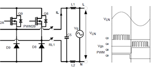

Hello TI.
I have noticed that in your TMDSSOLARUINVKIT the INV_PWM_2H (on GPIO3) don't have any signals so our question is what is the purpose of INV_PWM_2H in schematics?

Hi Wojcicech,
At the hardware level GPIO 3 is connected to INV_PWM_2H. Which is connected to the gate driver and its output INV_DRV_2H is driving the high side FET Q4. Was your question that you are not seeing PWM output on the GPIO3 from software?

Hi Pawan Nayak.
I asking about it because I saw on the osciloscope that EN_INV_PWM_2H have signal to FET Q4 and it is correct but I don't have any signal on INV_PWM_2H. Therefore my question is, is it neccessary to have INV_PWM_2H?
Yes PWM is needed for Q4. Are all the jumpers populated J19 and J32. Which build level are you using.
Regards, Pawan
Hi Wojciech,
The INV_PWM_2H is also connected to PWM-7A. Is the jumper J27 un-populated. Please remove jumper J27.
Also the ClearInvTrip variable should be set to 1.
Switch Q8(INV_PWM_2H) will only be switching for only one half of the cycle.
