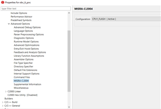

I am trying to enable the MISRA option for the compiler. How do i do that ? Why dose this list shows empty?

Hi Ashwini,
The MISRA-C 2004 was supported before but was removed in 2020.
Please have a look at similar topic to have more clarity-
