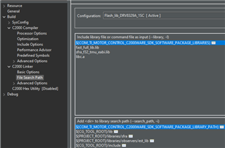

Hello all,
How is it that the IDE resolves the symbol of extern pointer name for a struct handle and editor mouse hover ctrl+click traverses to the define in another H file but the linker can't find the symbol by the referenced include in the calling C file?
I have tried moving function caller folder up and down file tree reference to the extern symbol below, rebuilding index every time. Odder yet adding include path to C file does link the defined symbol from the #include file name.
Adding the file path to the library tab produces an cannot open file error. So TI link to #10234-D suggestion to add path to library tab est.h is not *.lib file. These newer MCSDK projects do not link the symbol being named in another C file calling functions in est.h from extern top of est.h or added include. Moving the extern to other locations produces the same compile error messages. Setting the linker local project and setting index to search open files in CCS editor do not resolve the symbol linking failure. Past versions of <7.0 CCS if the symbol name resolved in the editor the linker had no problems finding the symbol.
How to fix below error message oddly does not occur in SDK v4.0 very same C file commands.c ?
Example: EST_setFlag_enableRsOnLine(estHandle, false);
//! \brief Defines the estimator (EST) handle
typedef struct _EST_Obj_ *EST_Handle;
extern EST_Handle estHandle;
Type Description Resource Path Location
C/C++ Problem unresolved symbol estHandle, first referenced in ./src_control/fexton/commands.obj is15_uvmcsdk_f28004x
C/C++ Problem <a href="file:/C:/ti/ccs1220/ccs/tools/compiler/dmed/HTML/10234.html">#10234-D</a> unresolved symbols remain is15_uvmcsdk_f28004x
C/C++ Problem #10010 errors encountered during linking; "is15_uvmcsdk_f28004x.out" not built is15_uvmcsdk_f28004x
C/C++ Problem gmake[1]: *** [is15_uvmcsdk_f28004x.out] Error 1 is15_uvmcsdk_f28004x
C/C++ Problem gmake: *** [all] Error 2 is15_uvmcsdk_f28004x
    Can you show me the error you're seeing?
    Hint: After adding library path to the symbols files properties tab of the defined extern symbol a new error message appears "Cannot open the file permission denied"
    New error seems to be caused by Windows 10 file security indicating CCS did not add a name to Users group during CCS setup or importing the project via REX to the new folders being created.
    #6001 cannot open file "C:/ti/c2000/C2000Ware_MotorControl_SDK_4_00_00_00/libraries/observers/est_lib":  Permission denied
    Make sure you have proper permissions for the file directory CCS and C2000Ware are downloaded in, and there is no firewall restrictions for CCS (or that CCS is excluded from any such security restrictions).

    The symbol (estHandle) is not resolving during linking. It seems the original project did not have a global export for the (estHandle) and functions could not be used by added C file callers (commands.c). Functions are needed for motor control in universal MCSDK FAST estimator inline. Oddly the extern symbol pointer works without issues SDK yet not resolve MCSDK during linking. The caller casting extern symbol (estHandle) to (est.h) inline functions are the same call both projects.
    Below exported struct handle pointer for each inline function (est.h) cast by caller. There is ongoing issue Boolean flag variables defined in typedef structs (bool) do not link state changes from custom modules added to MCSDK example project. Yet the very same bool logic flags (userParams.h) do change state when toggled true/false from (commands.c) SDK example project. We have to develop custom applications around existing example modules as they are specialized TI proprietary library calls for FAST estimator control (est.h).
    commands.c: EST_setFlag_enableRsRecalc(estHandle, false);
    est.h: //! \brief Defines the estimator (EST) handle

    I see you have the extern declaring the estHandle, but do you also have where it is defined? Extern will only say that the variable/pointer exists, but it has yet to be resolved/defined in another file (I'm replicating this on my side, so if you can provide this I will try to debug further).
    Omer Amir
  • Yes the Handle is defined as a typedef struct above post.
    I found a work around WA is to remove extern alias pointer(estHandle) in the function/s (est.h). Requires to also remove (obj->estHandle) pointers in caller/s MCSDK project that share inline functions est.h. Then the linker has no problem since the symbol is not used. Though what captures my eye is the extern symbol and function both have keyword (extern). This WA will not affect SDK project since it uses a different folder path, est_lib.
    Example: (est.h): extern void EST_setFlag_enableRsRecalc(const bool state); // remove {EST_Handle handle,}
    Callers sharing same function (motor1_drive.c): EST_setFlag_enableRsRecalc( obj->flagEnableRsRecalc); //remove{obj->estHandle,}
    /cfs-file/__key/communityserver-discussions-components-files/171/est.zip

    What do you mean by "create a link to custom C file"? est.h file gets linked in to the folder below and pulled from ${SDK_ROOT}/libraries/observers/est_lib/include
    Under MCSDK project import a virtual link to an added custom C file folder path as to control state changes of existing project flag names or call the embedded project TI functions. Even by adding *obj pointer to the customers function header the linker still fails to resolve estHandle during compile only. Also renamed above folders where path had same name (exton) and even moved it under libraries folder of SDK project made no difference linker to resolve symbol estHandle. So the Boolean flags compile and link but do not work without XDS110 simulator in standalone mode. Below only error to indicate MCSDK project is not linking correctly all of the modules. So many project handles appear to challenge linker even with recursive library symbol checks, omitts vital linking instructions XDS110 debug mode covers up. The SDK project does not have any of these issues and is the control for the MCSDK experiment.
    Can you provide screenshots of your error from your CCS workspace?

    As you can see below the pointer symbol resolved in the index and editor code analysis via check syntax as you type selected project properties. Also added a path to the est.h file in the linker library paths tab, linker still cannot find symbol estHandle. Worst of all none of the Boolean flags (_MOTOR_Vars_t_) struct execute or indicate state changes in the any customer provide functions when the flag state changes in any MCSDK module. These issues are seemingly linker failures as there are no functioning Boolean control links between customer modules and TI proprietary modules.
    The MCSDK bool flags only work in debug mode not from customer added functions even run in debug or standalone. Seemingly XDS110 Simulator *.out file code conversion covers up missing linker issues in debug mode. And Uniflash strips off symbols that make the project mostly dysfunctional when XDS110 is not connected. Yet the same customer added modules to SDK4.0 work in either CCS debug or standalone mode without XDS110 control states and after Uniflash firmware loads into launch pad.
     BTW: Communications, Sfra excluded from the project build
