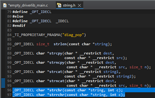

  • Hello Dan,
    These are the two similar-looking functions I found in string.h:
    Omer Amir
