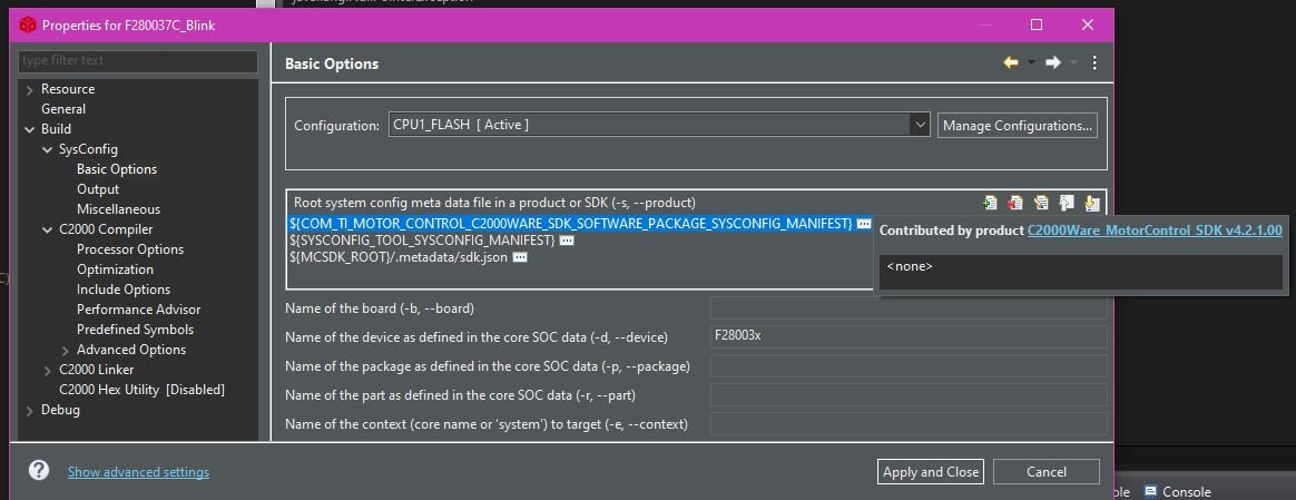

  • Strange, I see a c2000.syscfg folder placed in the project folder quite clearly.
    First, here is what is listed in SysConfig > Basic Options:
    I see this after a fresh import of the project in the directory (\universal_motorcontrol_syscfg\f28003x\"):
    For reference here is what I see in the folder to-be-imported:

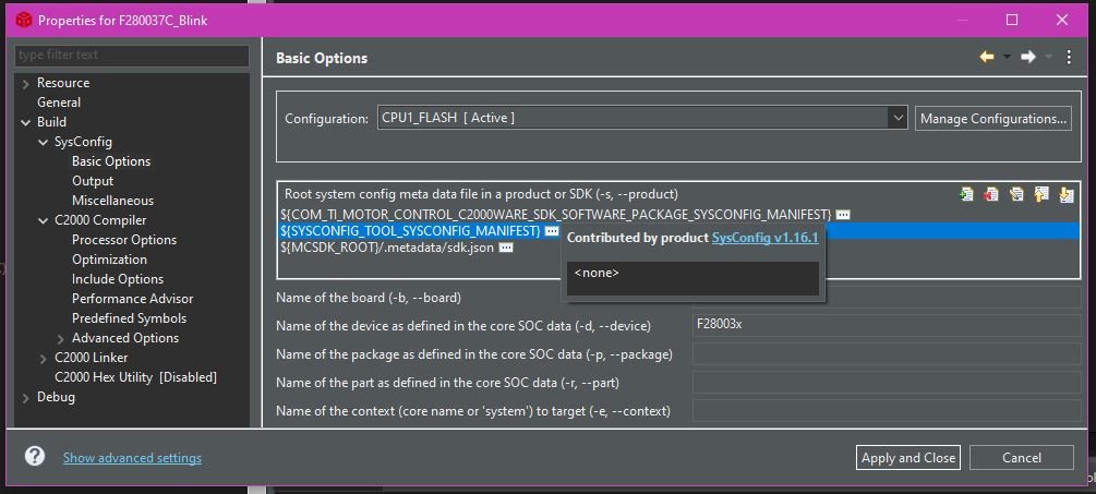

  • Hello Aric,
    To clarify I'm not talking about the c2000.syscfg file, I'm talking about the syscfg directory that the error is pointing out (./syscfg/...).
    From your basic properties, can you try removing the "${SYSCONFIG_TOOL_SYSCONFIG_MANIFEST}" row? If that doesn't work I will look into the steps you mentioned.
    Omer Amir
  • I removed the row, and get the same errors. Tried deleting syscfg folder and it was regenerated.

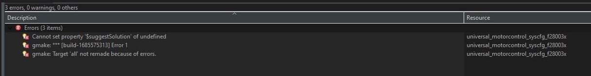

    Now, compiling gives errors:

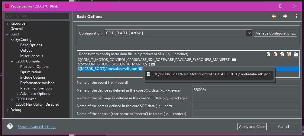

    Browsing through settings, I found that this is not the only place parts of the configuration are set:
    Setting this gives new errors:
    Up to this point, these errors are preventing ANY output files from being generated (syscfg and device folders generate, however).

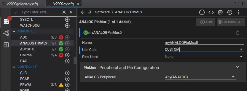

    I decided to remove all assignments in c2000.syscfg:
    Actually generates output files, then gives the following errors on compile. This is the closest I can get it.

    This code is auto generated and conflicts with itself.
    Any idea how to get past this?

    Here is the steps I followed, for any interested:
    1) Get a fresh import of the project 'universal_motorcontrol_syscfg_f28003x'
    2) Change the package settings here:
    and here:
    3) The settings won't compile after this change. There is a red X next to some analog pinmux settings:
    Toggle the 'Use Case'  from 'All' to 'Custom' then back to 'All' and this clears the errors and the project compiles!

    Also I think I found my real problem:
    Device Support was checked here. Unchecking it allows my fully configured original c2000.syscfg to compile.
    Maybe this was adding driverlib files that were conflicting with files already added by syscfg?
