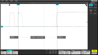

I want to synchronize ePWM modules on multiple devices via FSI in star topology. For this I played around with your example project "fsi_daisy_epwmsync_lead" on the LAUNCHXL-F280049C. I have a few questions about this.
For the sake of simplicity, I used the FSI loopback mode on a single F280049C controller. I configured the PWM slightly different and skipped the handshake initialization. I start a ping frame manually inside the debug session. If needed I can paste the code, but it should have no relation to my questions.
Here you can see a measurement:
Ch1 (black): ePWM1A (set when TBCTR = 0, cleared when TBCTR = PRD)
Ch2 (blue):  EPWMSYNCIN (EPWMSYNCIN signal with delay from CLB, according to the example)
Ch3 (red): FSIRXA PING Packet Received / CLB_GLOBAL_IN_MUX_FSIRXA_PING_PACKET_RCVD (EPWMSYNCIN signal without delay, according to the example)
SYSCLK = EPWMCLK  = 100 MHz
The pulse width of the "FSIRXA PING Packet Received" signal is only about one SYSCLK period. The CLB logic generates a delayed singal which is used as EXTSYNCIN1 in the ePWM. However, this signal is also only one SYSCLK period wide. In the data sheet SPRS945G of the controller, however, in section 7.11.3.2.1 a minimum pulse duration of two EPWMCLK cycles is required (asychronous). Since EPWMCLK is equal to SYSCLK, this time is violated. I have extended the pulse length up to 5 SYSCLK cycles by changing the clb configuration. But I found out that a longer pulse does not cause any change.
1) Is the synchronization of the example operated outside the specification, or is the value in the data sheet incorrect?
The cursors shows the latency between EPWMSYNCIN impulse and synchronization event. The delay is about 90 ns, which corresponds to 9 EPWMCLK cycles.
2) Is this delay specified anywhere in the TRM or in the data sheet?
3) Is this delay the same for all devices with type 4 ePWM units?
I found this in chapter 18.4.3.3. of the TRM SPRUI33F:
I assume that with internal module already an ePWM is meant and the delay of a chain, e.g. EXTSYNCIN1-> ePWM1 -> ePWM2 is described. Is this correct?
4) Is there any specification about the pulse length of the FSIRX pulses e.g. for FSIRXA PING Packet Received? I have not found anything in the TRM nor in the datasheet.
By measurements I found out that these pulse widths correspond to one SYSCLK period with type 0 FSI. With a FSI type 2, however, I could measure eight SYSCLK periods.
Thank you very much in advance.
Regards, Stefan
  • Hi Stefan,
    How are you going about bringing out the EPWMSYNCIN signal to a pin for probing?
    I'll need to check and get back to you on questions 1-3.
    No we don't specify this internal signal.
    What device did you use for the Type 2 test? The ePWM types and sync schemes may be different on these two devices. Also the internal connections used for the sync solution may be implemented differently.
    Kevin

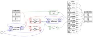

  • Hi Kevin,
    thank you very much for your reply.
    I used the structure from your document SPRACM3E and the related example fsi_daisy_epwmsync_node. In this structure/project, the CLB is used to generate a sync signal based on the delayed "FSIRXA PING Packet Received" signal. The delayed signal is passed to a GPIO for probing via an XBAR output and read back to the EXTSYNCHIN1 signal via the XBAR input.
    I was searching for another way to pass the "FSIRXA PING Packet Received" signal or its delayed signal directly to the EPWMxSYNCI, but did not find anything else. So I think I need to keep the bypass over the GPIO and XBARs.
    Here is my slightly modified code based on the fsi_daisy_epwmsync_node example:

    So I changed the CLB to extend the pulse width:
     * These arguments were used when this file was generated. They will be automatically applied on subsequent loads
     * via the GUI or CLI. Run CLI with '--help' for additional information on how to override these arguments.
     * @cliArgs --device "F28004x" --package "F28004x_100PZ" --part "F28004x_100PZ" --context "system" --product "C2000WARE@4.03.00.00"
     * @versions {"tool":"1.16.1+2960"}
    I believe this is the only (or best) way to make the connection.

    Regarding the length of the FSIRX pulses, my question is resolved now. It's fine for me that this value is not specified, since I determined the length by measurement. As I said in my last answer, I was simply afraid that I overlooked this information in the datasheet or TRM.
    I made a long time measurement to detect the sync jitter on the ePWM output. I found out that the latency of  EPWMSYNCIN impulse to actual synchronization event is constant. Previously, I had measured latencies that were sometimes different. The reason for this was a misconfigured cpu timer, which starts the ping frame on the lead device. On the node device the ePWM was synchronized to this frame. The cpu timer of the lead device and the pwm frequency of the node device did not match well, so there were occasional jitters. But this is not the case.

  • Hi Stefan,
    You may still see different delay measurements if measuring over a long span of time. This is due to the synchronizer along the C2000 FSI event trigger path, described in section 7.2.5 Theoretical C2000 Uncertainties of the App Note.
