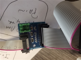

I am trying to program our proprietary target board which is designed around the TMS320F28035 using Uniflash and first the XDS100v3 and now the XDS110. I have been having extremely erratic results. Mostly it fails with the error message below. I have an interface board that the people who manufacture and program our boards supplied me with and have attached a pic of the setup but I do not have the schematic for that interface board at this time.
    Can you please explain to me the proper interface I must use between the JTAG cable from you XDS debug probe and the C2000.

    If you have access to an oscilloscope, could you try probing TDO (yellow), TMS (purple), TCK (blue), and TRST (green) as shown below? The screenshot below was captured using the XDS100, and it was a single-capture triggered on the falling edge of TMS. Could you try doing the same and see if your probed signals look the same?
    Are you able to share the schematic of your board?
