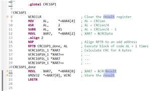

The .asm file that the customer created is shown below:
called assembly function:
Uint16 inputdata[6]= {1,2,3,4,5,6};
mycrc.CRCData = inputdata;
mycrc.CRCLen = 12;
CRC16P1(&mycrc);
The returned result is 0x8059, which does not correspond to the correct result 0xDDBA.
What is the reason?

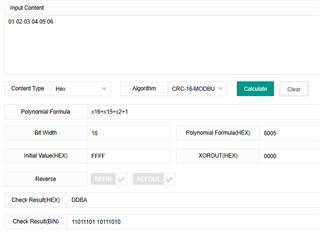

    Here it is:
    CRC-16-MODBUS
        x16+x15+x2+1
    The correct result calculated by online calculation is 0xDDBA.
    Thanks & Regards

    I tried the routines in controlSUITE\libs\dsp\VCU\v110\source\C28x_VCU_LIB and the result is also wrong. The .asm file code is as follows:
    ; Calculate the CRC of a block of data
    ; This function assumes the block is a multiple of 2 16-bit words
    		.if __TI_EABI__
    	  	.asg getCRC16P1_vcu, _getCRC16P1_vcu
    	  	.asg CRC16P1 , _CRC16P1
    	  	.asg getCRC16P2_vcu, _getCRC16P2_vcu
    	  	.endif
    ;	  	.def _getCRC16P1_vcu
    ;		.def    CRC16P1
    		.global _CRC16P1
    		.global _getCRC16P2_vcu
    		.global	_getCRC16P1_vcu
    ;		.text
    _CRC16P1
    		VCRCCLR 					; Clear the result register
    		MOV		AL, 	*+XAR4[4] 	; AL = CRCLen
    		ASR 	AL, 	2 			; AL = CRCLen/4
    		SUBB 	AL, 	#1 			; AL = CRCLen/4 - 1
    		MOVL 	XAR7, 	*+XAR4[2]	; XAR7 = &CRCData
    		.align 2
    		NOP 						; Align RPTB to an odd address
    		RPTB _CRC16P1_done, AL 		; Execute block of code AL + 1 times
    		VCRC16P1L_1 *XAR7 			; Calculate CRC for 4 bytes
    		VCRC16P1H_1 *XAR7++ 		; ...
    		VCRC16P1L_1 *XAR7 			; ...
    _CRC16P1_done
    		MOVL 	XAR7, 	*+XAR4[0] 	; XAR7 = &CRCResult
    		VMOV32 	*+XAR7[0], VCRC 	; Store the result
    		LRETR						; return to caller

  • Yale,
    In the picture you shared of the online CRC calculator tool, what do the check marks on REFIN and REFOUT in the Reverse field refer to?
    Sira
  • Hi Sira,

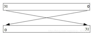

    When REFIN is True, each byte of the input raw data needs to be processed in reverse order. Attention please: For each byte, not the entire data, take a 4-byte raw data as an example:
    When REFOUT is True, the output data needs to be processed in reverse order of the entire data. Attention please: The reverse order operation done here is different from REFIN, it is not byte reverse order, but the entire reverse order. Taking CRC-32 as an example, the final data is 32 bits. When REFOUT is True, the reverse is as follows:
