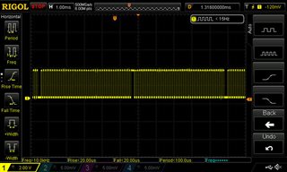

IN THE BELOW STATED PROGRAM I HAD INTRODUCED AN EPWM INTERRUPT. IN THAT TO CHECK THE STATUS I TOGGLED A GPIO PIN. ON OBSERVING THE WAVEFORM AT TWO INSTANTS THE PULSES ARE MISSING. i AM UNABLE TO FIND OUT THE REAL CAUSE OF THE SAME. HEREWITH I AM SHARING THE CODE AND THE WAVEFORM OF THE SAME FOR YOUR REFERENCE.

{ GPIO_togglePin(8);
if(x == 1)
  { EPWM_setCounterCompareValue(myEPWM3_BASE, EPWM_COUNTER_COMPARE_A, 0);
    EPWM_setCounterCompareValue(myEPWM4_BASE, EPWM_COUNTER_COMPARE_A, 0);
    EPWM_setCounterCompareValue(myEPWM2_BASE, EPWM_COUNTER_COMPARE_A, 0);
    EPWM_setCounterCompareValue(myEPWM6_BASE, EPWM_COUNTER_COMPARE_A, 0);
  x=0;
  else {EPWM_setCounterCompareValue(myEPWM3_BASE, EPWM_COUNTER_COMPARE_A, duty);
        EPWM_setCounterCompareValue(myEPWM4_BASE, EPWM_COUNTER_COMPARE_A, duty);
        EPWM_setCounterCompareValue(myEPWM2_BASE, EPWM_COUNTER_COMPARE_A, duty);
        EPWM_setCounterCompareValue(myEPWM6_BASE, EPWM_COUNTER_COMPARE_A, duty);
        x=1;
    // Clear INT flag for this timer
    EPWM_clearEventTriggerInterruptFlag(myEPWM2_BASE);
    // Acknowledge interrupt group
    Interrupt_clearACKGroup(INTERRUPT_ACK_GROUP3);

    Also share your header file where you are defining GPIO_x_EPWM_X_X to pin number that is passed to GPIO_setPinConfig(). I assume you are using c2000ware code files as reference.
    To understand more on the code. You are toggling GPIO 8 in epwm2_isr to just to check when it enters the ISR based on epwm 2 trigger event ? and the waveform you shared is for of same GPIO8 ?
    Also what is the event selected on epwm2 to trigger an interrupt ?
    As an alternative you could also read the ePWM Interrupt Event (EPWMx_INT) Counter Register (INTCNT) in ETPS Register more details shown below snapshot :
    In this way you could correlate the pulse output to counter when its expected or not.
