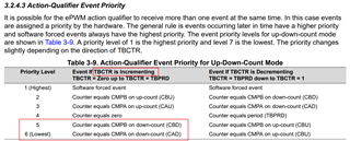

When TBCTR is incrementing in up-down count mode, why CBD and CAD event can happen? And CBU&CAU for decrementing.

The CBD, CAD when TBCTR is incrementing should never happen. I am taking an action to file this and remove those rows as they seem to provide no value to the customer.
Thank you for bringing this to our attention.
