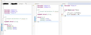

Hi George,
So, we have code that utilize unnamed fields, specifically unnamed structs. The compiler is giving an error when we try to use these structs.
To give an example:
If I try to access members of s1 from an instance of s2,like, s2->current compiler gives and error.
We have used these unnamed fields with fms-extensions flag. I have relaxed-ansi flag in setting as per c2000 compiler manual as well.
I meant to say that this type of code works with fms-extensions flag on other gcc based mcu.
This variant of unnamed fields you use, where struct s1 is not completely specified inside of struct s2, is not supported by the C28x compiler.

Hi George,
Thanks for the quick reply. The reason I am asking about this is that our internally architected code uses unnamed fields a lot to create a modular design.
Could you give me an example of how you would create an unnamed struct inside a struct that satisfies the C2000 compiler?? Maybe we can adapt our internal code to support this variation for reusability. Any suggestion here will be much appreciated.
Bharath
struct s2 { struct { uint16_t init; uint16_t current; }; uint16_t data1; uint16_t data2; };
The unnamed struct must be completely specified inside the named struct that contains it.
