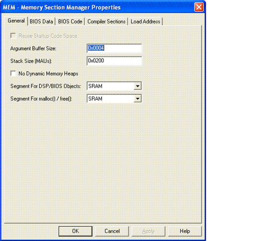

  • John --
    I assume you are using DSP/BIOS.  Can you please specify the version?
    I suspect that the problem is related to not having a heap configured in your BIOS configuration.   printf() internally calls malloc().  If malloc() fails, the printf() will silently fail.
    Check this dialog box and make sure that the "No Dynamic Memory Heaps" check box is unchecked and you have a valid memory segment specified (not MEM_NULL).
    -Karl-
