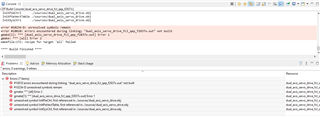

    When I copy this code I get the following errors:
    Could you please help me with this?
