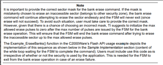

TMS320F280033: FSM may never exit due to wrong mask when calling Fapi_issueBankEraseCommand
Part Number: TMS320F280033
Hi Team,
There's an issue from the customer need your help:
Mentioned in the manual zhcuao0b Page12
The sample code is as follows:
u32CurrentAddress = Bzero_Sector8_start;
oReturnCheck = Fapi_issueBankEraseCommand((uint32 *)u32CurrentAddress, 0x001F);
// Wait until FSM is done with bank erase operation
while (Fapi_checkFsmForReady() != Fapi_Status_FsmReady)
// Initialize the Erase Pulses to zero after issuing max pulses
if(HWREG(FLASH0CTRL_BASE + FLASH_O_ACC_EP) > MAX_ERASE_PULSE)
EALLOW;
// Enable Flash Optimization
HWREG(FLASH0CTRL_BASE + FLASH_O_OPT) = OPT_ENABLE;
HWREG(FLASH0CTRL_BASE + FLASH_O_ERA_PUL) =
HWREG(FLASH0CTRL_BASE + FLASH_O_ERA_PUL) &
~(uint32_t)FLASH_ERA_PUL_MAX_ERA_PUL_M;
// Disable Flash Optimization
HWREG(FLASH0CTRL_BASE + FLASH_O_OPT) = OPT_DISABLE;
EDIS;
