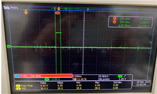

I had issue with GPIO12 and GPIO16 which are turning on for some time when there is power supply because of default internal PullUp, I've changed them to GPIO6 and GPIO7 which has pullup disabled by default as per the datasheet
But unfortunately, in some boards these pins are getting high for some duration which is not expected.
Can you please explain why this will happen.

  • Hello Mr.Amir,
    As I'm facing another issue while flashing or debugging mentioned in TMS320F28035: Flashing issue in TMS320F28035. Device locked, I've not tried another unit to run in debug mode.
    So, the issue I've mentioned is during power up of Unit. Device won't be reset until power is OFF.
    The below picture is of GPIO7 pin when unit is powered up. It can be seen that it is high for 32.56msec.
    Madhu
  • Hello Madhu,
    Based on a discussion I had with a design expert, the boot code may make all IO pull-ups enabled by default, so even though it is disabled by hardware, the boot software will enable it. I've reached out to a boot ROM expert to see if this is the case and whether anything can be done about this.
    Omer Amir

  • Hello Madhu,
    Based on what the boot ROM expert told me, the ROM will only pull up unbonded GPIOs (pins not available for the specific package). To narrow down this issue further, have you already monitored that nothing else besides power is connected to the board when you turn it on/startup your code? Have you monitored the power and ground rails of the device (i.e. VDD, VDDIO, VSS)?

  • Hi Madhu, from the other thread we learned you are using internal VREG to power the 1.8V supply.  In that case we can dismiss the power sequencing concern for now.  That said it does appear the 12V supply is not fully powered by the time the F28035 is powered and presumably reset is de-asserted.  I'm not saying that is related to GPIO7 but could mean some external devices the F28035 is interacting with are not ready.  That is just an observation.  Of course you may have an external supervisor holding F28035 in reset until the rest of the system is verified ready.  i cannot tell from the power supply image in the other thread.
    To debug the GPIO7 issue further, we would like to understand a few things about the behavior:
    1) For a device which shows the unexpected toggle of GPIO7, does it occur on every power up?
    2) How much passes from XRSn going high and the GPIO7 toggle?
    3) Does it occur only on power-on reset or also on a warm reset (manual assertion and release of XRSn).  Now that the flash issue is resolved, I'm hoping you can try this on a board?
    4) Are you using INTOSC or XTAL for clocking F28035?
    regards,
    Joe

  • Hello Mr.Joe,
    Sorry for the delayed response. As we have caught up with the other issues I couldn't replied to your queries. Please find the answers below
    Regarding controller supply, as there is a LDO for 3.3V, once the 12V supply builds around 7V it will give 3.3V output.
         It happens on every power up.
         This we will check and confirm with you
        It is happening on every Power ON reset. With the JTAG after flashing and run it in debug mode relay turning on is not happening. So, the issue observed is when there is a power reset
        We are using External Oscillator of 20MHz

  • Hello Harish,
    We seem to understand the issue but need to confirm with trying on different units. Seems like at power ON, we are getting some garbage in CAN frame which resulting in enabling the charging process and turning on the GPIO7.
    Madhu P
