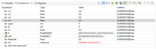

  • Hi Omer,
    As you said, I added the section from LS0 to LS5 and other RAM sections, but as seen in the figure I added below,after this procedure, the values assigned to the variables on the expression screen are incorrect (All values are zero). For example, I define float w1=0.4, w2=0.3, w3=0.2, w4=0.1; but their values are very different in the expression window. This is also valid for other variables.
  • In addition, if I need, how can I sue flash like RAM?
  • Hello Baris,
    Are you defining their values outside the scope of a function or within some part of the main program? Are you using COFF or EABI output format in your project properties?

  • Hella Omer,
    My section to define values is below.

    Definitions both outside the main code and inside the values do not appear in the express window.
    Finally, I'm using COFF format.
  • Hello Baris,
    If you define the variables individually instead of inline, is there any change? I know I had trouble initializing global variables in a single line, but I don't remember if I used the same syntax/variable type.
    Try this:
    float w1=0.4;
    float w2=0.3;
    float w3=0.2;
    float w4=0.1;
    Omer Amir
