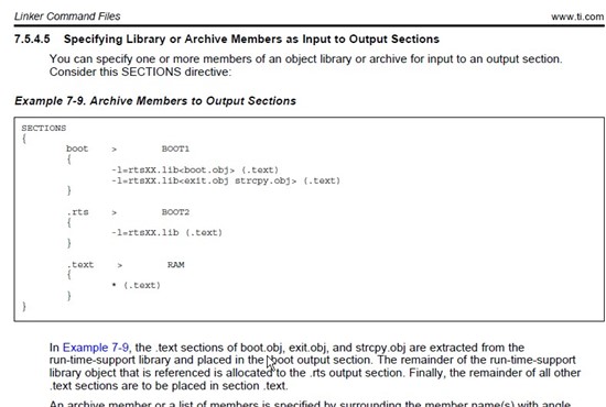

  • Tom,
    tom prohaszka said:
    Thanks, this does work.  But is there a way to only put specific functions in RAM?  The above method will copy any IQLib function used into RAM, and this can be large.
    Tom
    You can pull different .obj files from a library into different sections.  This is shown in www.ti.com/lit/spru513
    You can examine the .map file to see what the .obj file names are for different functions.
    Cheers
    Lori
