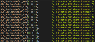

  • Yes. How do I configure the ADCIN6 on the f2802 to read the analog input signal (490 hz, variable duty cycle)???
  • Hello Michael,
    If you looked at the example I cited within CCS and looked up the declarations of the functions, you can find that the function "void ADC_setSocChanNumber(ADC_Handle adcHandle, const ADC_SocNumber_e socNumber, const ADC_SocChanNumber_e chanNumber)" is used to configure the SOC's channel number.
    To clarify, an SOC of a particular ADC can sample any channel that that ADC has connection to; in this device the ADC can sample the following channels:
    For configuring the SOC to read the input ADCIN6 (I'll assume you're asking to use ADCINA6), you would just need to use this enumeration in the function call. Please look over the example and let me know if you have any other questions on it.
    Omer Amir
