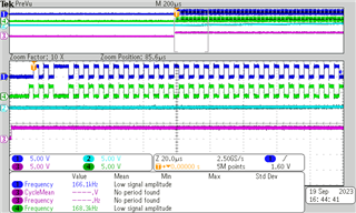

Hello, in previous forum here: LAUNCHXL-F28379D: Is there a way to synchronise the CMPSS, DC and TZ modules to the PWM frequency? - C2000 microcontrollers forum - C2000Tm︎ microcontrollers - TI E2E support forums
I had been attempting to stop the PWM trips from clipping the signal mid-cycle, such that I always had 50% duty cycle.
Messing around with the rising and fall edge triggers of the GPIO enable signal, I have managed to get something working OK.
However, at what seems like random times, the PWM frequency of EPWM2B (yellow) and EPWM1B (green) will often seem to "latch" their duty cycle, or something similar, such that the frequency appears approximately twice that of the desired duty cycle. Here is a photo of the problem:
Complete code is below. This may help you to see the problem yourself and to help debug. I am using the Launchpad. I believe this is easier, rather select the code snippet, as I am unsure where this is coming from.

Since I use active-high complementary PWM dead-band, this unfortunately also messes up my EPWMxA/xB relations as shown below:
JMH.
  • Hi JMH,
    I'll see if I can recreate the issue on my end using your code and will get back to you tomorrow with my findings. In the mean time, can I ask if you saw any related issue like this before implementing the rising/falling edge trigger with the GPIO enable signal? Or was it just the clipping of 50% duty cycle that was the issue you were trying to resolve?
    Allison
  • Hello Allison,
    I cannot really say, as I always had this operating at fixed duty, phase, and frequency. It seems to be when implementing modifying the registers I get this problem. I can try again tomorrow without the phase control to confirm.
    If it helps, this problem originally seemed to have something to do with my interrupt from the PWM, which was originally generated every 15 cycles. This “double frequency” cycle artifact would then occur every 15 cycles or so. If I changed it to 5, then it would occur every 5. I can’t remember what I changed to get to this point, as I forgot to commit changes to our systems version control. But now it seems to occur just this once, and then for the rest of the ENABLE period, the phase control works fine. Strange.
    I think if you can recreate on your end you’ll spot it with your expertise quickfast!
    JMH.
  • Hi JMH,
    I was able to recreate the issue you are seeing with the PWM signals. I did see that you had posted earlier today about changing the action qualifiers- just wanted to double check if adjusting the action qualifiers did resolve the issue? On my end it also seems that the latching only occurs once on EPWM2, do you still see it on both EPWM2B and EPWM1B? The pattern does hint at an issue with the interrupt timing which I'll look into further.
    Allison
  • Hi yes, I apologise I do not know where my reply has went. I have attached as photo as I cannot paste text here. Your thoughts would be appreciated. I cannot recall what else I changed, but modifying the AQ cleaned the issue right up. I am still running the interrupt at the same frequency it was originally, I had just set up an additional PWM module at 15kHz to update the phase value, rather than doing this on the 15th interrupt of a 150kHz PWM (my main inverter frequency).
    I can’t recall if I had the issue on both PWM modules 1 and 2, but their action qualifiers are set exactly the same.
  • No worries at all, glad to hear that the issue has resolved! It's definitely worth looking deeper into to find the real culprit. Would you mind sending your updated code, so I can compare?
    Allison
