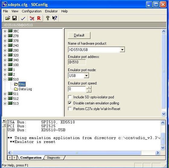

  • OK, SDFlash is doing the same thing that CCSPla v3.3 is doing.  It cannot connect to the emulator.  I know the emulator is capable of functioning:
    SDConfig Test
    I printed off the HTML document on setting up and testing SDFlash and configured it based on what I see from SDConfig:
    I had to hunt down the ccBrd0.dat file which is why it is on F: (USB drive).
    When I try to reset the emulator to test if things are working or not I see this:
    SDFlash Reset Result
    I don't know if there is any older engineers out there that might have experience with SDFlash and can possibly give me an idea of what may be wrong.  Unfortunately the computer system the original CCS configuration was running on was decommissioned over 10 years ago when the customer said they would never need any more of the 2407 based boards.  They came to us asking for another "last batch" of the boards and while we have all the bits and pieces we can't seem to get the tools to work properly.  BTW, I'm even running all this on an old Vista laptop which in theory should work but for some reason will not.  Any assistance anyone can provide would be appreciated.
  • Oops, forgot to show that the emulator can be reset, at least it can via SDConfig:
    SDConfig Reset
  • The fact that you see messages like "Found JTAG IR length of 8" and "Emulator is reset" tells me that the scan path is good and that the PC is able to communicate to the device via the scan chain. Did you try Prg2xx? It is a command line utility with less dependency. You may have to change the port address in the batch files from 0x378 (parallel port) to 0x510 for USB. Are you also sure customer board is a working board? You could try another board, if you have one. Sorry I am unable to help better.

  • OK, finally found a work around so I figured I'd share it here in case anyone else needs to know how to do this.
    Note: CCS Platinum version 3.3 will not work on the more modern versions of Windows.  There are 2 services that it needs to invoke during install that aren't there in later versions of Windows so when trying to start CCS things won't run.  I had to get this running on an old Vista based laptop.
    It turns out that the CCS tool defaults to using a driver located in C:\CCStudio_v3.3PLA\drivers\tixds24x.dvr. It is shown in the F2407 configuration.  The "Modify Properties" DOES NOT allow this to be changed for some reason.
    This driver does not seem to work with the Spectrum Digital XDS510USB.  To get things working I went into the C:\CCStudio_v3.3\drivers directory and located the driver that the SDConfig program uses since I knew that it was working.
    I renamed the tixds24x.dvr file in the CCSPLA driver directory to tixds24x.dvr.original.  I then copied the sdgo24xusb.dvr file from the CCStudio_v3.3 drivers directory into the CCStudioPLA drivers directory and renamed it to tixds24x.dvr so that it was invoked by CCS. This works or at least it did for me.
    Note: BEFORE running CCS you will need to run SDConfig so that it "enumerates" (activates?) the USB port to the XDS510USB emulator.  Things should work as normal from then on.
