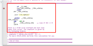

   As long as a delay function is activated, the below phenomenon will occur.
   below is delay function
Whether there is a correct CMD file?

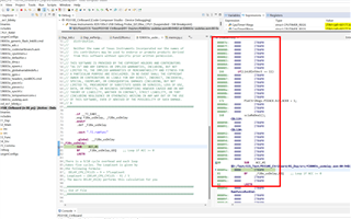

        Checked .map file the result on function “f28003x_usdelay” is shown below
    The result of running the programme is shown below
    single-step operation The code get lost.
    I can't pinpoint the cause of the problem.
  • Dear Omer Amir
      Is the above problem due to the fact that the corresponding RAM space is all 0000 ITRAP0?
     May I ask what makes RAM space is all 0000 ITRAP0?
    Were you using the single-assembly step button? It's the green arrow (the yellow arrow is for stepping through a C line of code).
    Yes, this looks like the source of the problem. It looks like either you're overwriting the memory, it's being re-initialized at some point, or some other operation in the program is causing it to be overwritten. I recommend stepping through your code and finding at what point that memory changes (at the start of your program it should have whatever functions/data you store in memory there). Once you find the line which clears that memory, you can single-assembly step through it to find out what's going on.
