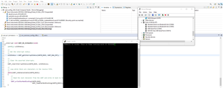

I'm trying to configure CM-UART for my project starting from uart_ex1_echoback example from C2000 Ware 5.00.00.00, but if I run the example I have wrong characters echoback. I'm using a uart_config_c28x to configure overall pin muxing of my TMS320F28388D controlCARD and I followed uart_ex1_echoback initial comment for external connections with a USB-RS232 converter and Putty (or CCS Serial Console) configuration. I also tried to change baudrate with no success.
I think is a baud rate issue, but I don't understand how to fix it: can you confirm the example is ok? If not, can you help me to fix the issue?

  • Hi Fabio, the example works fine. What config are you using in the terminal? Is it matching as per the comments in the example? Also, can you double check the hardware connections that you've made?
  • Hi Aditya,
    I double checked the external connections and I can confirm I have communication, just wrong characters.
    I'm using this configuration in CCS Serial Terminal (the same is and happens with Putty, COM3 is my USB-RS232 converter):
    This is my present code with a little change to observe received character:

    But if I press "m", with a breapoint in the interrupt, I can see in Variables:
    then a null character.
    It turns back "[":
    I saw in TMS320F28388D controlCARD user manual, pin 84 is a boot mode pin (the S2 position 1 switch): can it be the origin of my issue? Unluckly, GPIO42 (other UART TX pin) is not in the docking station pinout to do another test.

  • Hi Aditya,
    thank you for your patience, for sure I was always proceeding as you wrote.
    This is my setup:
    By the way, I checked better that, when I was receiving those weird feedback in my previous posts, or the emulation had to be restarted, but I don't know why, or some happens with other baud rates, it seems that some are worse than others and it is not correlated to speed, e.g.: 9600 or 500000 are worst than 115200.
    When everything starts in the right way, at 115200, my communication works but it is very noisy:
    But I can say it is working in some way, maybe my setup is too bad: I'll try to improve it.
    About S2 switch, I have tried all the combinations with no difference, by th way my last one is: S2.1 at OFF and S2.2 at ON.
