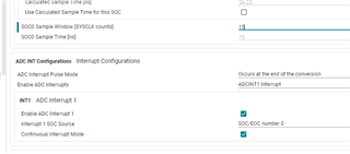

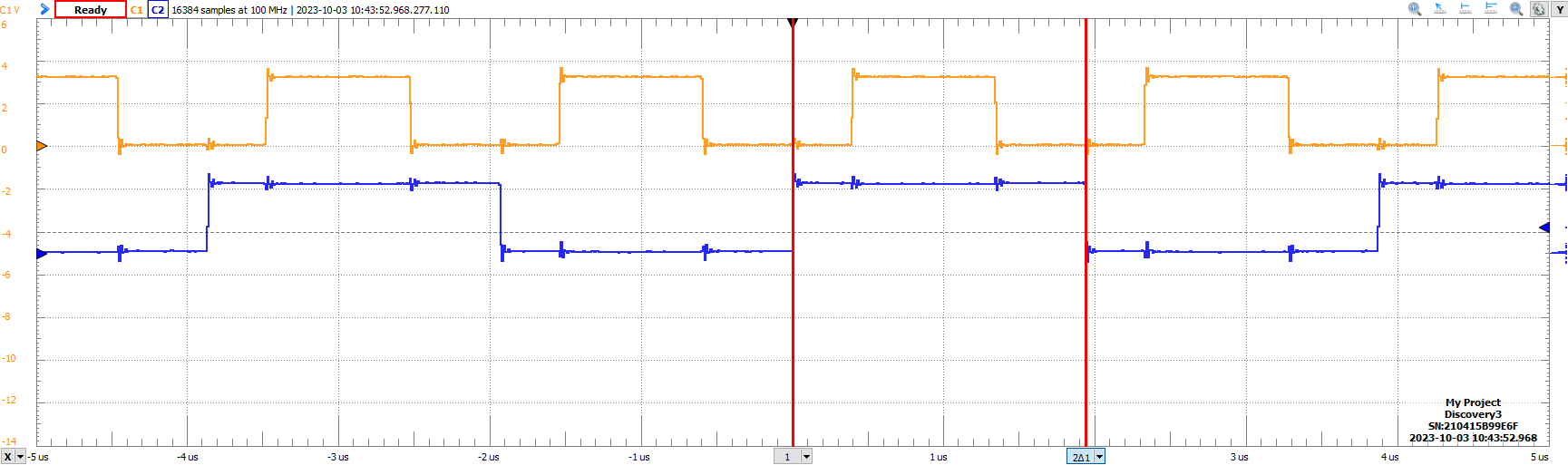

    In this example, without any optimization, the contents of the ADC interrupt is above 2µs (orange curve, with a delay before and after)
    In a first run, I configured the sample time to 2560ns. The conversion time is 210ns.
    Since I am in the continue mode, each time I enter in the interrupt, an interrupt pulse is generated, and a new sample begins. The duration of the interrupt (orange curve) is less than the duration of the sample duration. So we leave the interrupt subroutine before the next pulse.

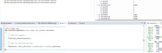

    Even if this subroutine is quite long, we enter periodically in the main loop, and every thing seems to work. But if I take a look at the register in the debug mode, I can see that the Flag is not cleared after I ask for it:
    Actually, the ADC_ClearInterruptStatus has no effect

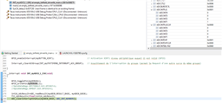

    Ti compare, I tried to use the non continuous mode:
    Even if I cannot see that the bit ADCINTFLGCLR.INT1 is set, I can see that the flag is clear.

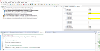

    So, come back to the continuous mode, but with a smaller sample time (75ns).
    A pulse is generated befor the flag is cleared. That is normal. But since it is never cleared, it looks like a new pulse is generated at the end of the interrupt, not because a new conversion is done, but because we leaved the interrupt, and the Flag is set. So we enter again in the interrupt subroutine. We never enter in the main loop
